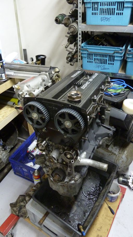

PostPosted: Sat Dec 24, 2011 5:15 pm

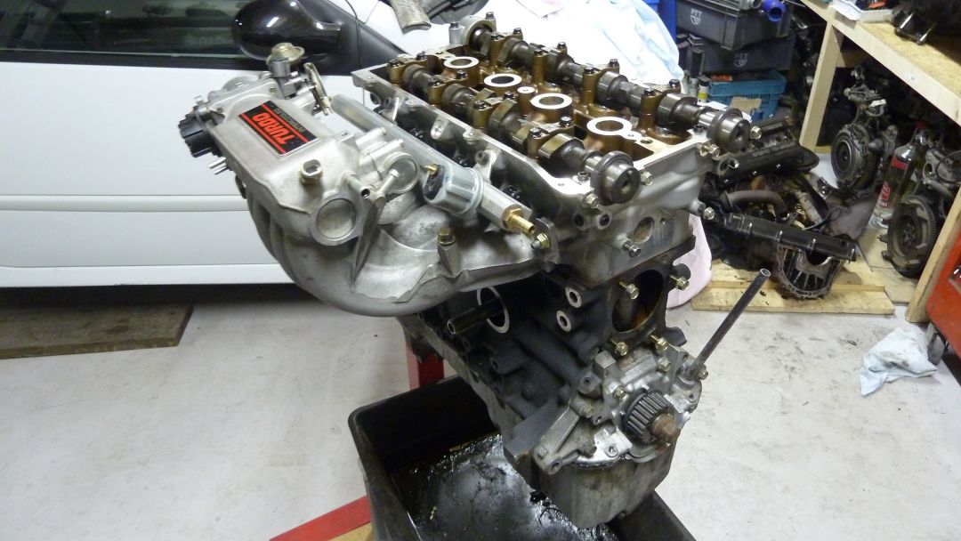

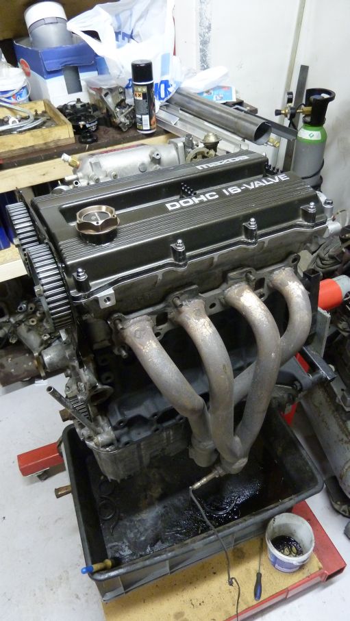

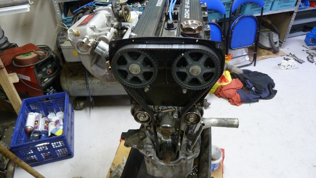

Updates;
Exhaust manifold, pre-fit. Needs some work at the bottom
Waterpump on, camgears on, cambelt rollers? on, rockercover with new gasket put on, waterpump outlet with new gasket; check
New thermo and gasket
Old versus new... and what do you know; a golden lodge :lol:
New cambelt, Gates Powergrip
Acc. belt and waterpump pulley on, including the engine mount and the alternator. Even de toothed wheel and crank pulley bolted on.
So, it is almost ready to go in the car :D

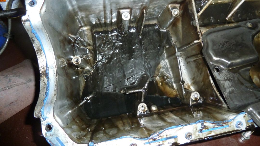

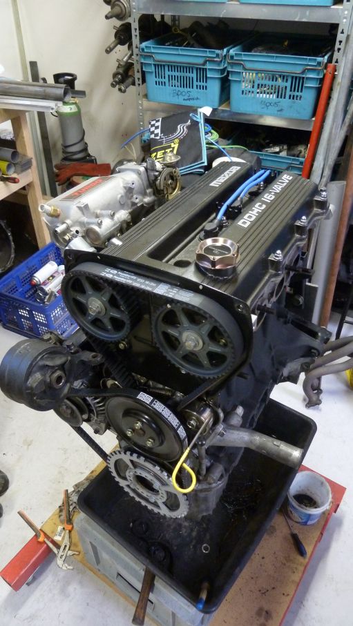

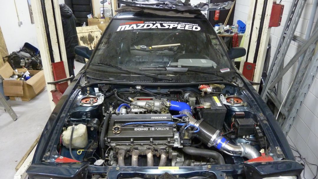

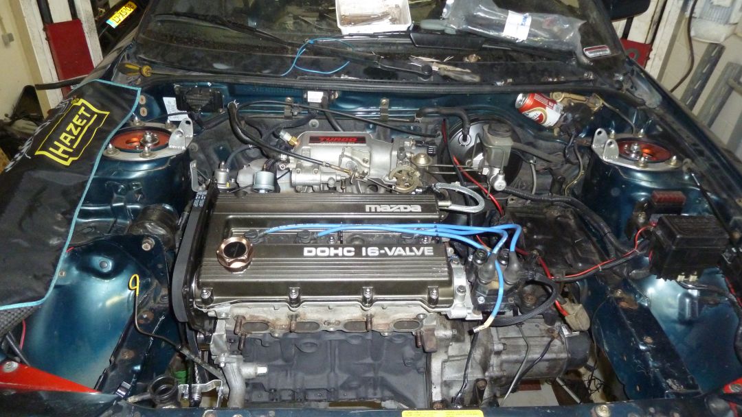

Updates on the car.

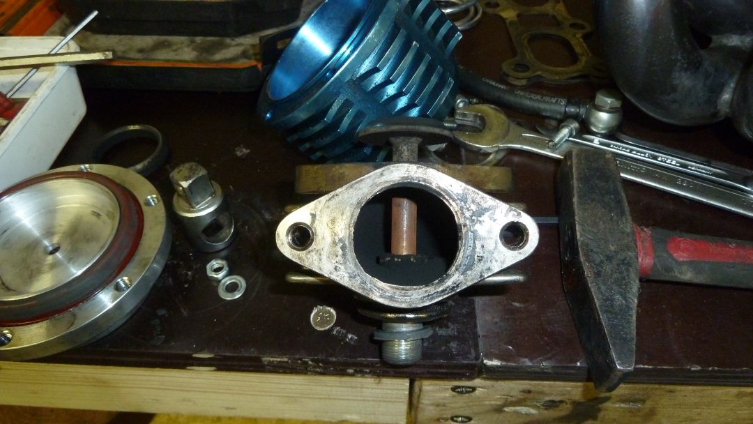

We found out the reason(s) why the turbo engine died.
A faulty wastegate. The valve was not moving a single bit. With some heavy use of a hammer it came undone. It had been rusting badly :evil:
As for the rest, the leftovers in the oil in the sump was telling us that there is coolant in it. Headgasket failure as it seems , it probably died because it was
running with an very high pressure (1.2bar/17psi and more (quick scan in the megasquirt logs)) of the turbo with the faulty wastegate.
Anyhow, on to the new , non-turbo engine 8)

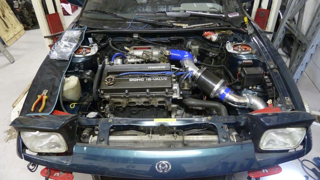

Engine mounted in the car, wiring loom connected and some hoses
Inlet and all the hoses/electrical wiring connected, oil and coolant is already in
Placed the battery finalised some bits and the exhaust refitted
Starting will be done maybe today, maybe tomorrow. We are planning to get some spare ignition parts to be sure (coilpack and edis4 module).
Monday a package will arrive with some heatwrap in it for the exhaust manifold. Will be put on next week. It needs to run first.

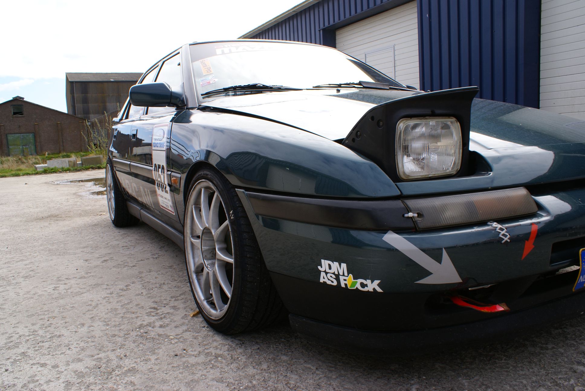

PostPosted: Mon Jan 09, 2012 10:19 pm
epiphone wrote:
Hi mate, can i ask what front splitter you have and where you got it?
bougth it at a breaker, its from a Renault Senic

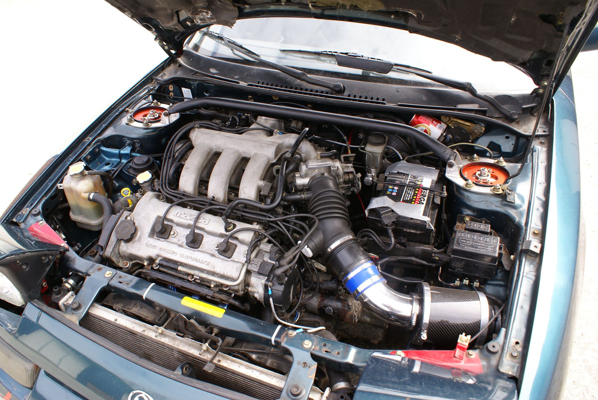

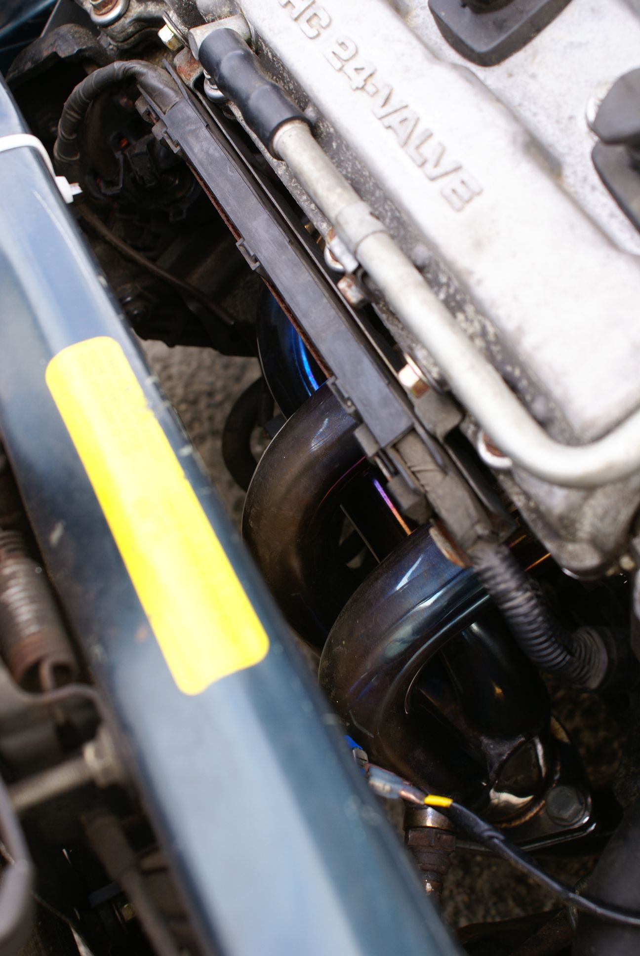

PostPosted: Mon Apr 09, 2012 11:50 am

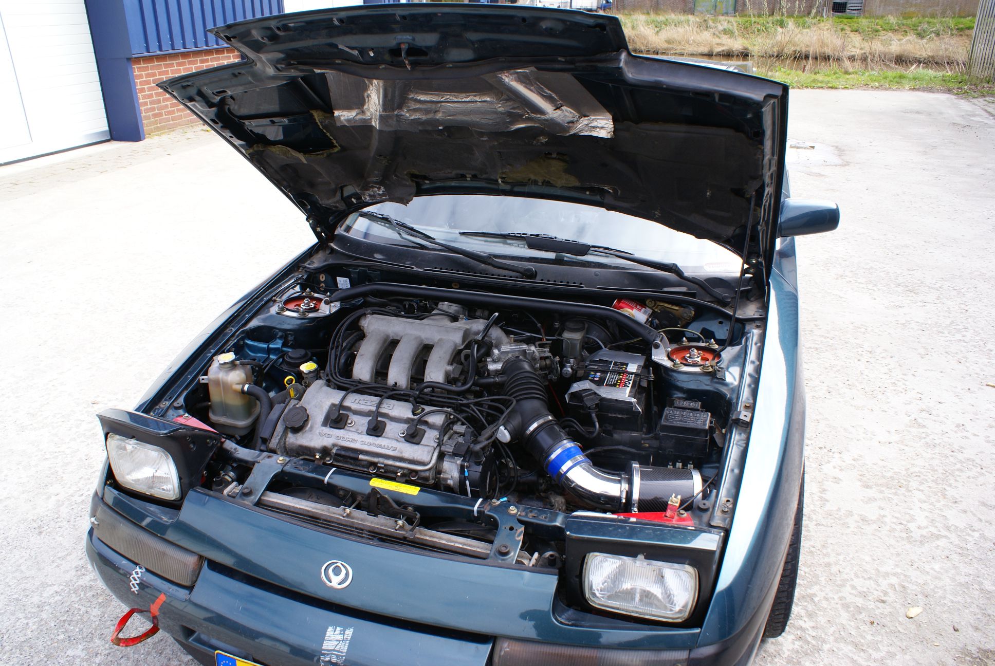

Right,
Some updates frome the NL. The whole megasquirt setup did not wanted to work on the new 1.8 engine as well. Only 2 cilinders firing, outer two drenched... So the time kept on ticking and the first round of Time Attack here in The Netherlands was closing up on us we decided to go further on the N/A part. And that in the shape of a V6! 2 Weeks for the first round we have thrown in an 2.5 from the Xedos9 (Millenia) which had stock figures of around 170bhp. Did need to buy a complete MX-3 for it but does it matter ? :lol:
And it worked! The engine keeps on running and holds nicely even after the Time Attack round.
Some engine specs;
2.5 V6 KLDE @ 170pk stock (kl31 heads/curved-neck intake)
KL07 ecu (chipped by DTA Motorsports)
JE50 VAF
M2 Performance exhaust headers
K8 flywheel
6-puck stage3 clutch frictionplate
255l/ph Walbro pump
Estimated power output @ 180-185 bhp
And the rest ? Original Mazda! Alright, the suspension and so not, but engine-wise there is not much changed.

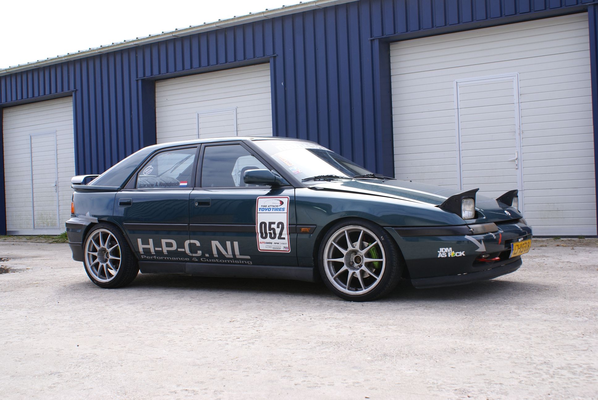

Photo time:) Click on it to get it bigger.

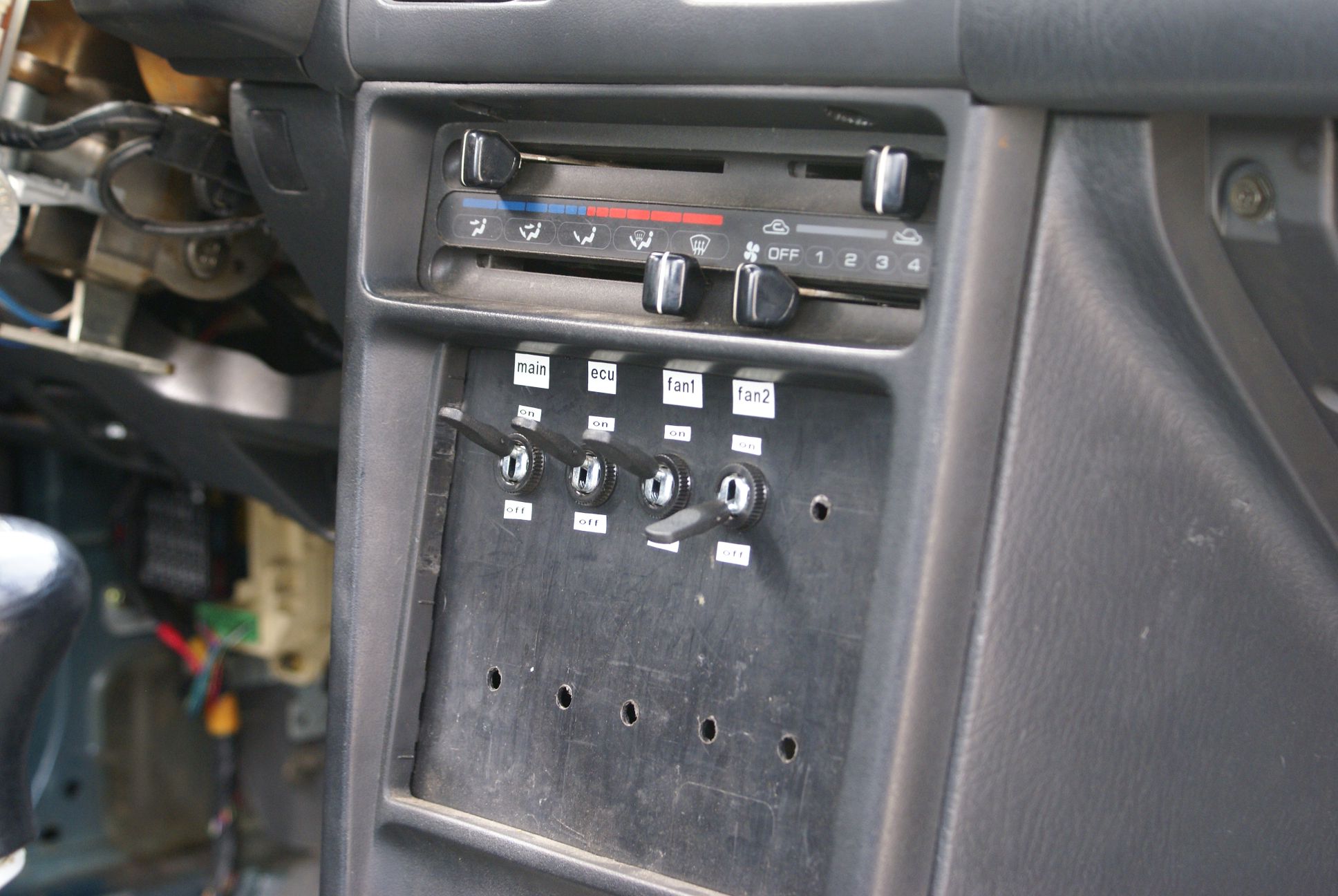

Adri's "office"
Functional switches
The engine

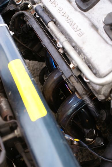

Exhaust manifold, stunning colors
The car itself 8-)

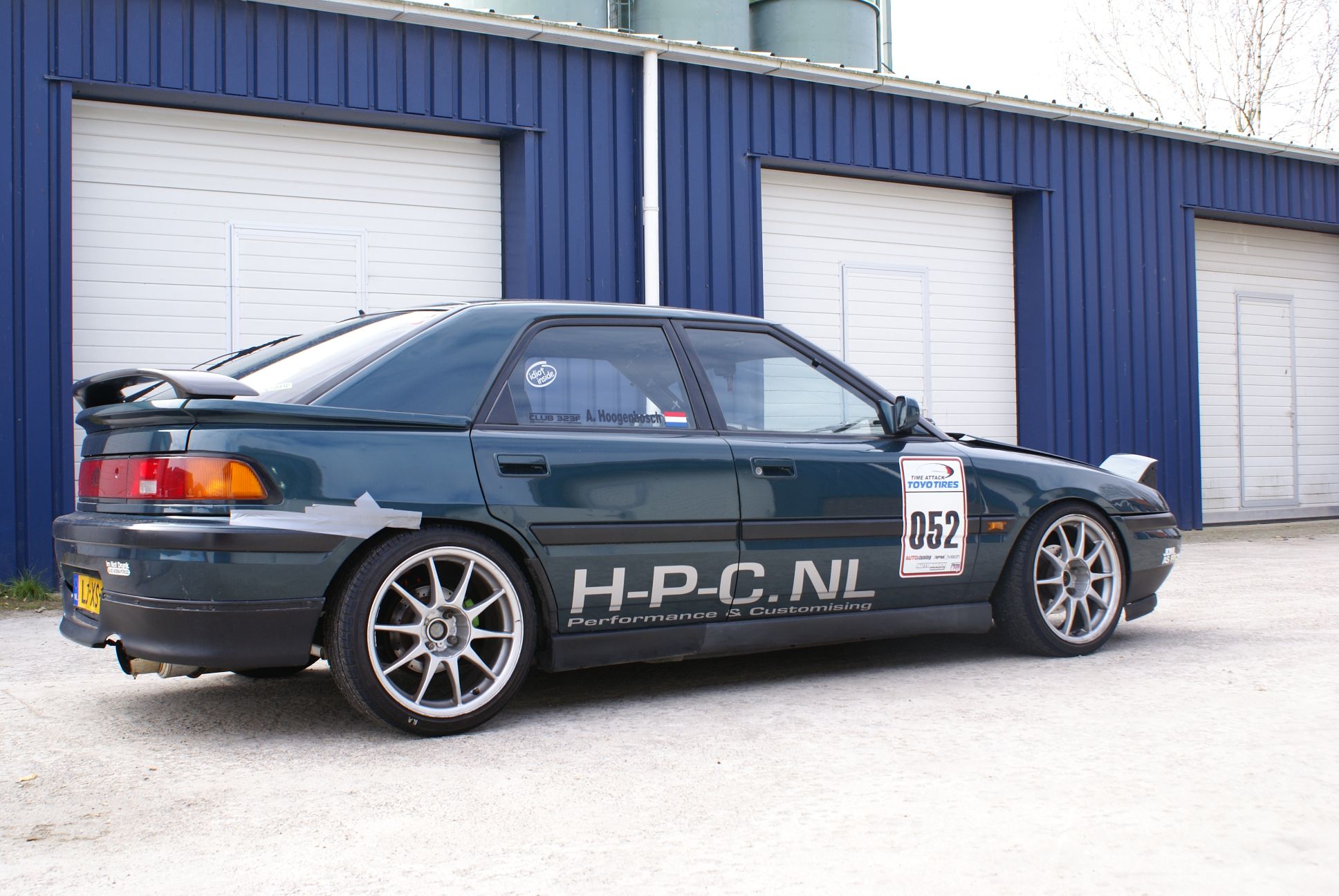

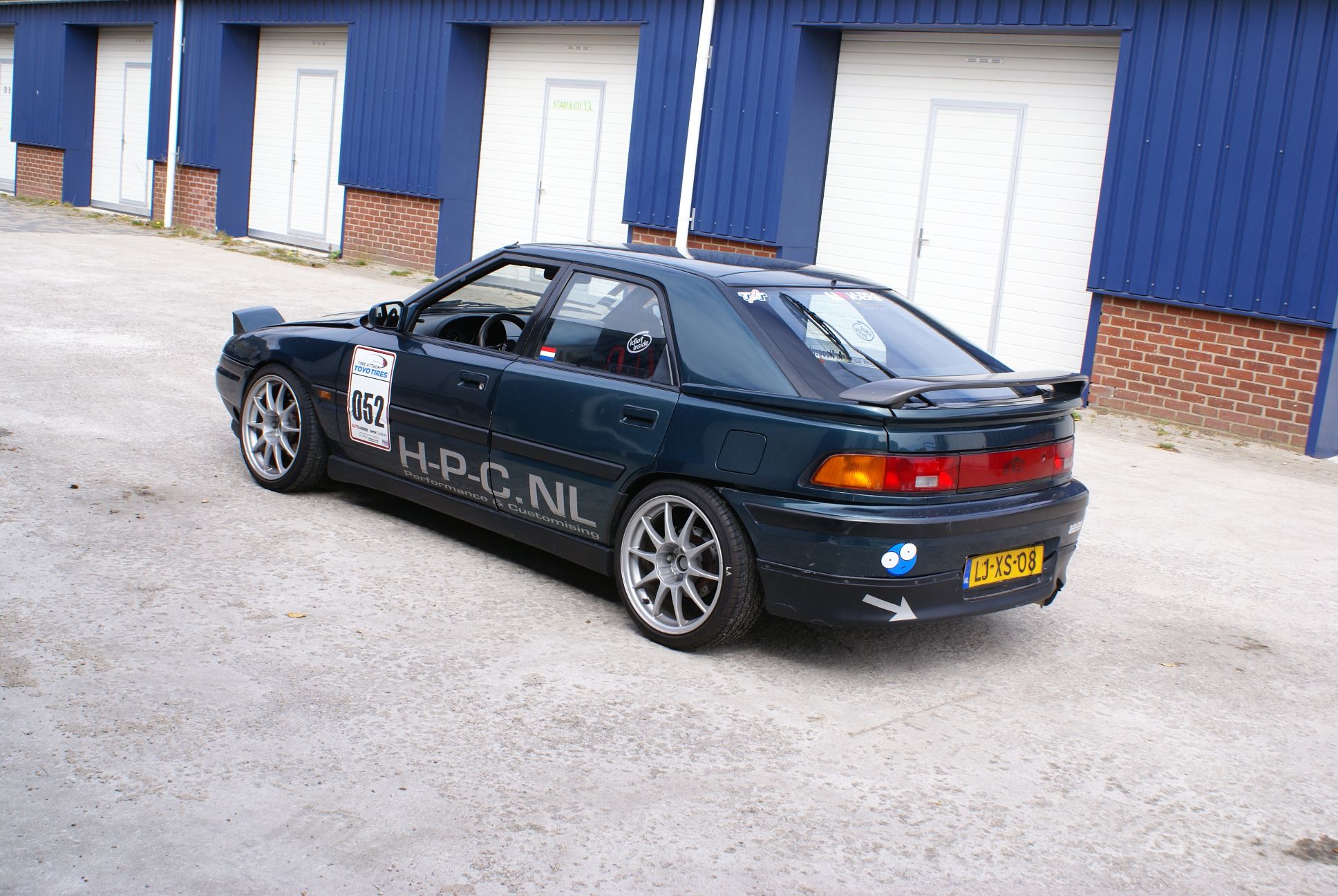

@ Circuit TT-Assen , 1 april Time Attack. With a different set of popup (or stay-down) lights (the other with the lights can't close because of the radiator) and running on the Yokohama Advan AD048 tires @ 15" Borbet alloys.
The BA in front of me is Max, not to be confused with Barreljan ;)
And I even did make it to the finals in the Semi-Pro street class! Overall standings after the first round is 5th of an amazing field of 27 cars running for the championship!
Now hope it's not going to breakdown. If all keeps well, we even can make progress for a long time with all the engine troubles. First progress is already made, I've ordered some new brake pads (EBC Yellowstuff) because I can't keep up with braking...
:D :D

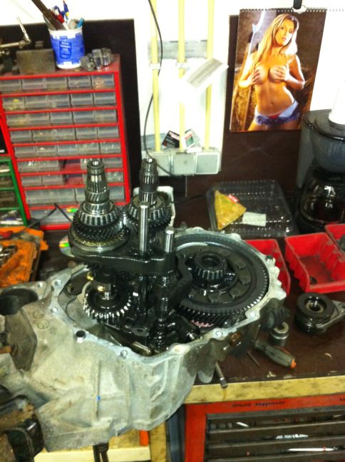

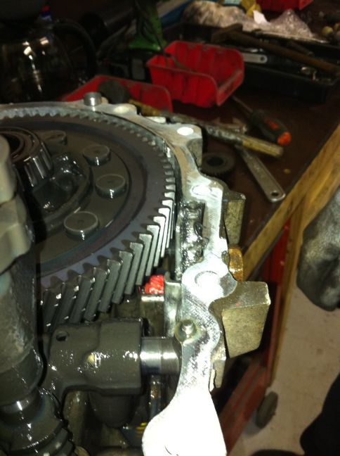

PostPosted: Tue Apr 24, 2012 10:18 pm

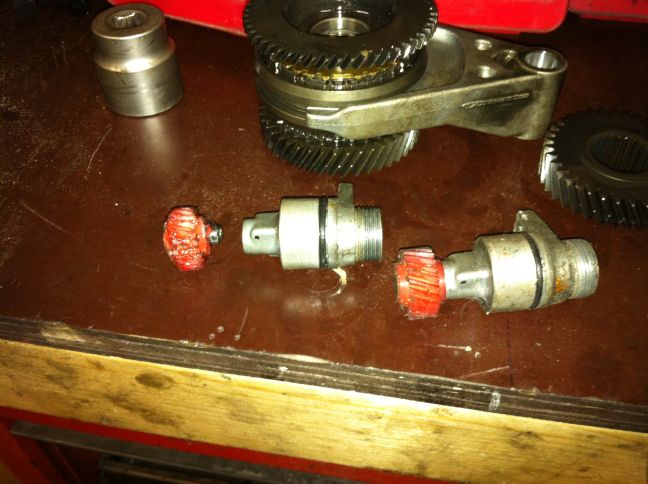

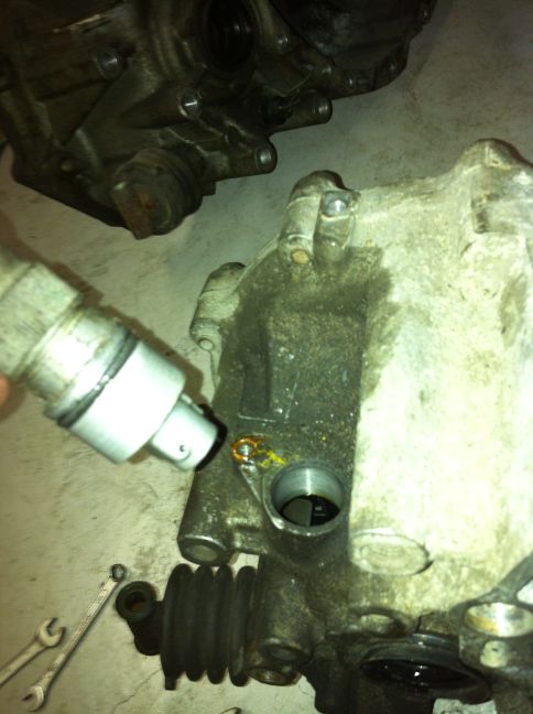

Before the first time attack round I already had some gear changing issues. It was sometimes there, sometimes not. We had the idea that the shiftrod underneath the car (modified BG one) was not the correct length. So tried a good MX3 v6 one; no change in the problem.
Tried to sort it out today by guessing the gearbox was dying and removed the MX3 gearbox. With the prepping of the MX6 gearbox we had in the shop and swapping some sensors I found out what the actual problem was.
Sorry for the crappy picture quality
It seems the differential had eaten the gear on the speedo sensor....... :shock:
So, time to get it a part
Well, there's your problem! I can seeeee you
Broken versus good
It's good it didn't smashed up the whole gearbox :lol:

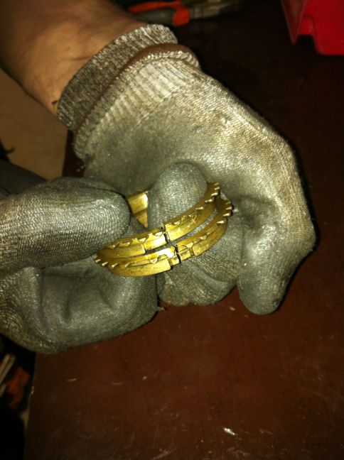

PostPosted: Sat Apr 28, 2012 9:29 am
And, will you are at it, lets replace the synchromesh rings as well
If shifts again like a charm! All gears are selectable without any fuzz
