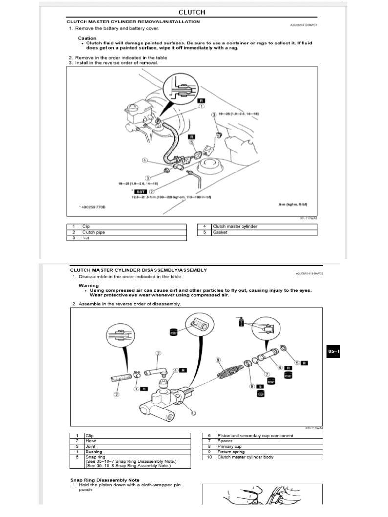

but here's the relevant page from the manual, do let me know if you need more detail:-

Many thanks for your reply, the only thing is the diagram you posted shows the layout of a left hand drive car, exactly the same as the manual I have myself.
What I need is a diagram or photo's for my right hand drive car. The left hand drive one looks very easy to do. I am guessing my clutch master cylinder is going to be under the combined clutch/brake fluid reservoir, and by looking under my bonnet, it looks like it is only accessible from underneath. That's a bummer though.

Yes you're right … the only other manual I have is the Haynes for a BG, and that does indeed say "from under the dash, remove the nuts holding the master cylinder to the bulkhead".
I guess the same applies for the BJ.
