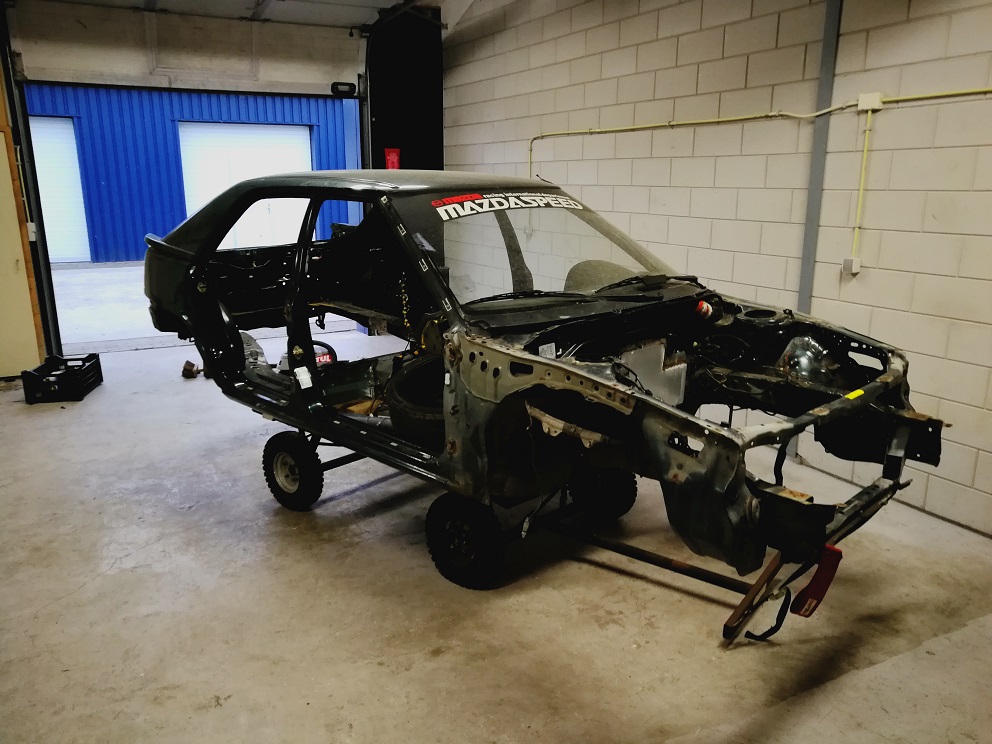

Update 08-11-2017
I have made the pre-assembly from the square tubbing. H-shape
With the radical modification I can experiment with this frame and the subframe, to determin where it shoud come.
I will cut more metal from the rear the vertical bit on the rear under the rearligths where the spare tire is original, make some clearance for maybe a diffusor?
I have found a nice topic on a rx7forum about modifying the gearbox, this means that i can push the KLZE more in the car and stil shift in a good way :) yeeahh :cheers: means that the weigt is more behind the frontwheels. Downside is the oilsump.. that one has to be modded aswel. :roll:
Next steps
:arrow: Controlearms and position of the pre-assembly. When that fits i could weld it on place.
:arrow: Determin the location of the engine and gearbox. ( i have to modify the RX7 gearbox shifter mechanism )
:arrow: Make engine mounts, based on originals (front gearbox )
Please dont look at the mess

Update 16-11-2017
So i have managed to get the lowercontrole arms mounted on the hub and rearsubframe. It looks like they fit, (for now) they will be replaced eventually with pillowball arms.
And as far as i can see, the position of the wheel looks quite good. This wheel doesn't have the rigth specs but it does the job for now.
I have meassured the shiftermechanism from the RX7 gearbox, i'm able to get the shifter back in the original spot of the chasis. Which means that the engine is flush with the bulkhead (firepanel?,dashpanel) 8)
SOOOO next steps,
:arrow: Weld the pre-assembly on/in the chassis
:arrow: THAN... more cutting in the chassis as i need to make some clearance for the gearbox and engine

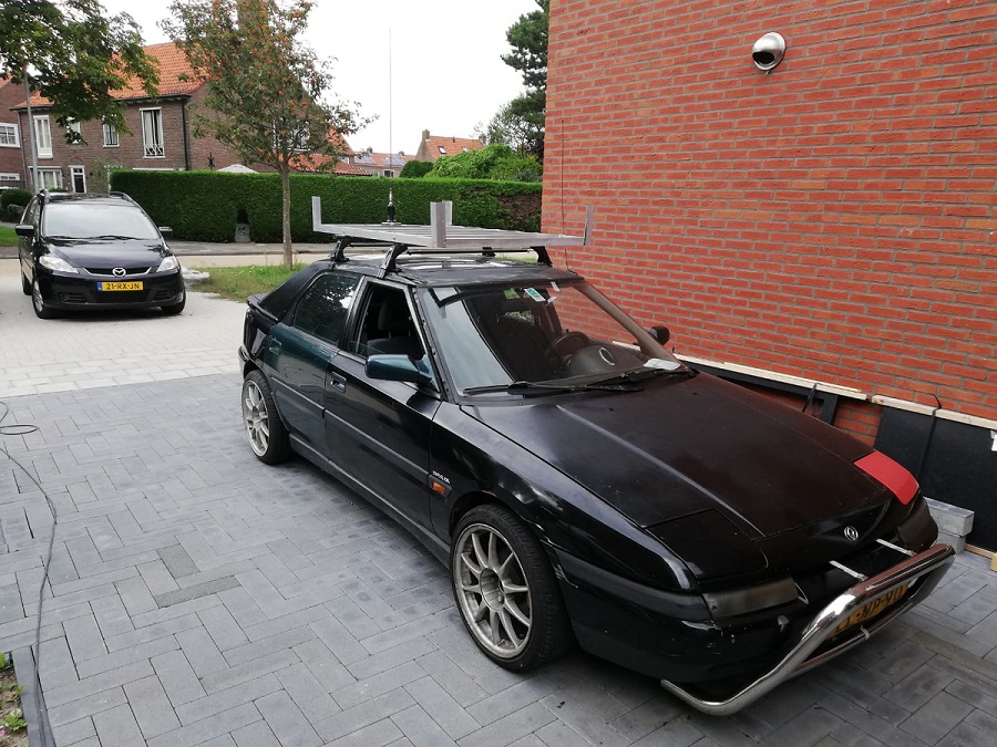

PostPosted: Tue Aug 21, 2018 11:22 am
hi there all,
a small update
The mule is going for MOT, the chassis of Hades is put away in a shed for futher plans, i have some ideas but need to work on those. will be a pain in the butt to fix but probably worth it. I could not trow this car away Sooooo i have to make the best out of it.
