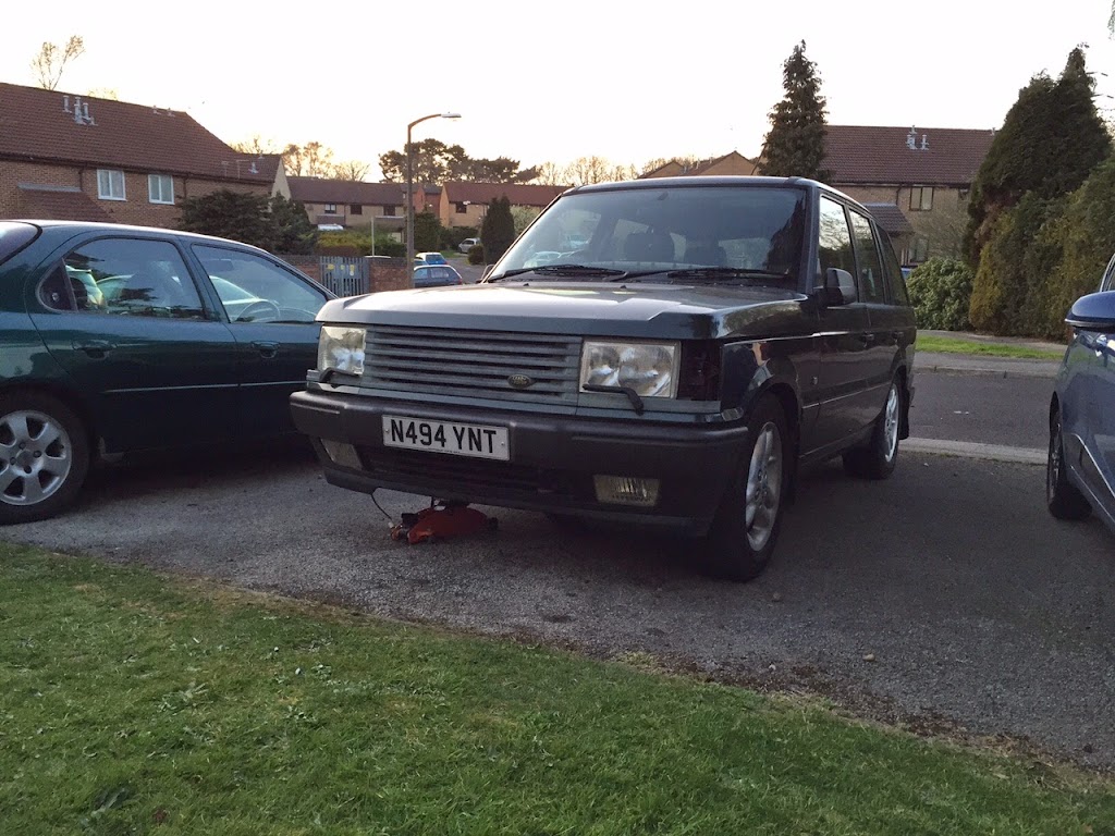

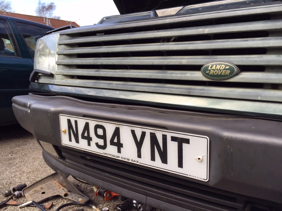

Accidentally forgot to take my pills a couple of months back...
It's a Range Rover P38, obviously... but importantly in these pictures, the engine is running (albeit sort of on 8, sometimes 7 cylinders), the electrics are mostly working, and the air suspension has air in it!
It's the 4.6 V8 HSE auto with multipoint LPG, and Harmon Kardon audio. And it does make a nice noise :) But that's about where the good points end at the moment. The paint is as naff as it looks, the front and rear bumpers need replacing (front is warped, rear has been reversed into a bollard), and it has or had just about every little problem a P38 could have.
When I viewed the thing, it ticked (at the time...) all the 'must be working' boxes. It went up and down, the engine sounded nice, no tapping or steaming out the back. The majority of electric things inside worked - and those that didn't I wasn't concerned with. The interior was nasty, but would clean up. So all 'good' from that side... and I bought it.
Problems I knew of to begin with, along with the obvious bumpers...

It then turned out I had a loss of coolant that was getting worse. A header tank would last 25-30 miles. Took a while to (hopefully) sort this, the heater was leaking, the radiator turned out to be leaking, and the pipes to the LPG vaporiser were leaking. The last two would evaporate leaving just antifreeze residue behind.... nothing on the ground.
For now at least I've disconnected most of the LPG kit and replaced the coolant hoses with original items. The installation is a mess, and for the miles I'm going to do in this, I don't really think its that necessary. Might sort it, might just sell it.
Anyway, a while back I renewed the plugs and leads, and apparently after that it started to idle a bit roughly. I couldn't remember if it did before or not... memory like a sieve. It would splutter at the exhaust and sound a bit naff, but increase the revs and it would run fine. Looking at the basic diagnostic data I could get with what I've got, the fuel trims were way off, possibly caused by being run on LPG for ages if that wasn't setup properly. I went to do a compression test, and actually found one of the new plugs I'd put in looked like it had been dropped almost completely closing the gap. Must have missed that. Re-gapped it and it now idles lovely :) Still need to see about getting the trims reset, hopefully restoring some performance.

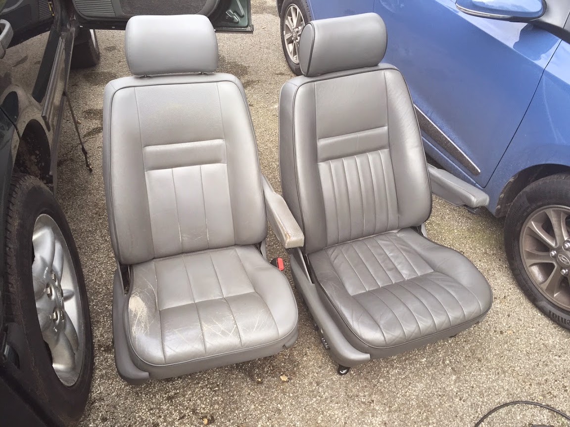

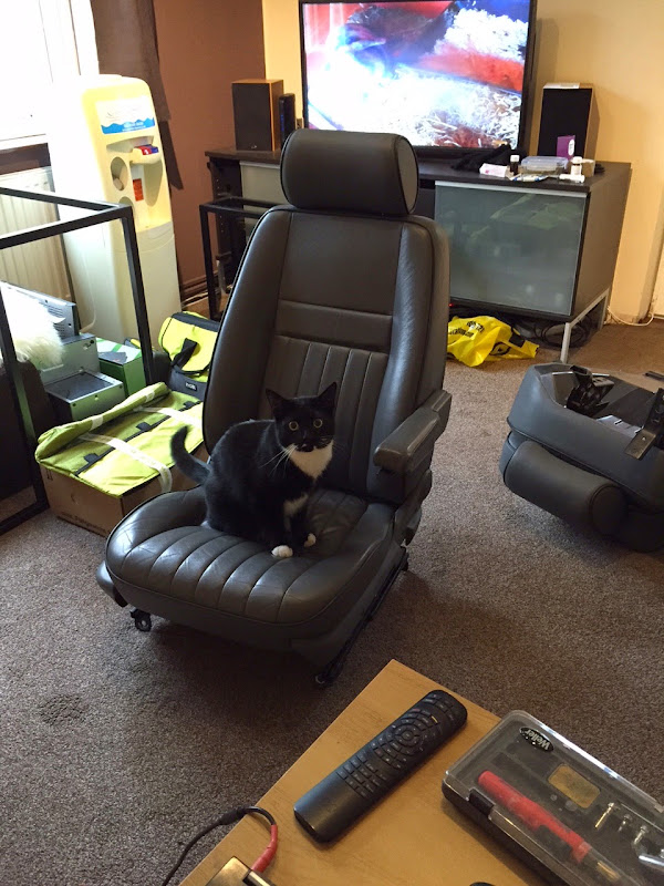

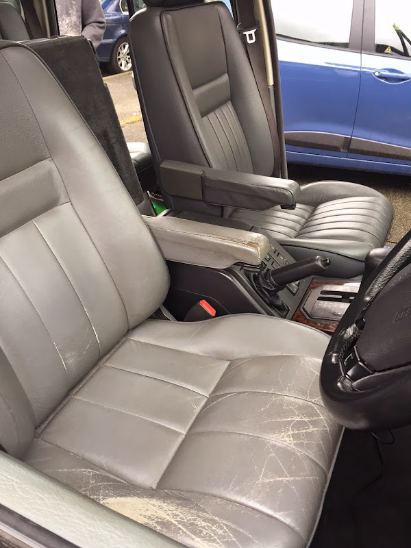

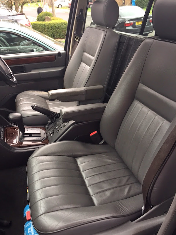

On to the interior... I forgot to take pictures before spending a few days getting started on inside. Carpets and seats were all nasty - especially in the boot. Dogs must have been in it a lot, as well as being used for building supplies or something judging by the grout in the carpet. The pillar covers were particularly nasty, not helped by the tacky covering Land Rover put on them... some kind of fuzzy mess. Some kind of flocking maybe?
Under hot water the stuff comes off easily though, then just needs some white spirit to remove the glue. Look far better bare.
Before:
After:
Then it rained. So they're still on the floor :lol: Plenty to be getting on with, thankfully parts are cheap and plentiful for most things, so this has become a bit of a project.

Great work on the interior parts there sloth. Definitely ping to be lovely by the time you finish with it

Is it me or you have problem with suspension? or maybe somebody is in the car when you made the photos!?
The left side is lower to the ground than the right..
Or it's the lean of the road? But i doubt it's that..
Check it.

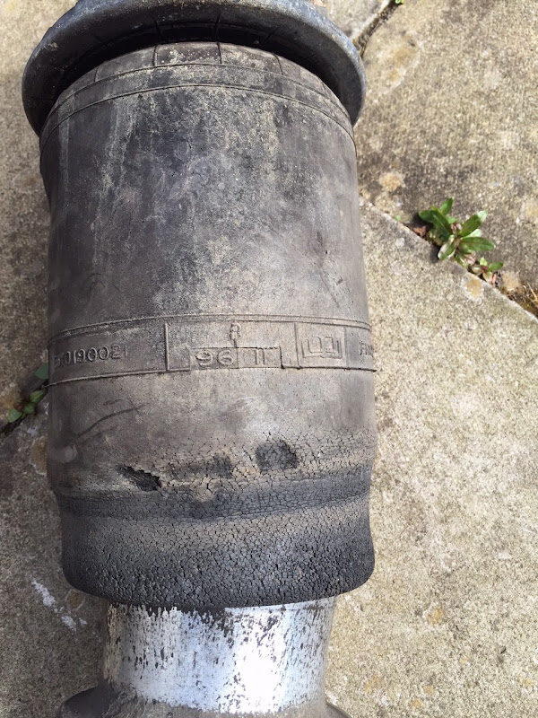

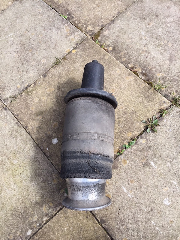

Yep, the air suspension is leaking, mostly from the front left bag or its valve. In those photos it hadn't levelled itself out completely, so its a bit lop sided :lol:

The air suspension on my van (rear only) if I remember correctly is pretty similar in design to the Range Rover system, and yes it leaks all the time, you will never get a 100% seal. The best you can hope for is that it'll stay up for 5-7 days, and that's normally only in summer. Winter? 2 days max on mine.
If yours is anything like mine the pipes that lead in to the air springs and out of the various solenoid boxes will be a kind of push in self locking sealing round clip thing. What I found on my system was that over time the clamps had indented the plastic tube and thus weren't sealing very well. Removed them, trimmed the ends just enough and very carefully (have to be flat on the end and no burrs) and pushed them back in. You shouldn't use any kind of sealant as this may get in to the system and cause a blockage!
Fyi, they are a huge pita to undo. You have to push the pipe in then pull the tiny little tab of the sealing clip out, then the pipe should remove. All the while its under pressure and harder than a Chinese finger puzzle! If the system has air it makes a freakishly loud wooshing noise when you remove the pipe, hope you don't have a pace maker cos the pipe pops out when you least expect it.
I Also tightened up a big brass seal on the main air tank. Since then not too bad, but once down people are always asking if I've taken the engine out as the nose looks really high :roll:
Does yours have any kind of kneel function? this should blow air back out of the system via the air filter on the compressor and can be important for removing moisture from the system, something else that can affect the level of the ride.
At least yours should come with a manual. My van being ex-LAS was custom built by the body shop UVG and as such there are no manuals, or spares really, only old blokes that used to work on them that you have to find and ask. Good times!
EDIT > Just remembered, if you get one of those plant sprayer bottles and put a mix of water and some washing up liquid in and squirt it over your air line connections and air bags. Any leaks will froth up like they've got Rabies and show you clearly where the leaks are.

Yep, same situation - though pretty much on the bump stops overnight if doors are opened a couple of times - the system then tries to level itself out by letting air out of the other bags. So to match the passenger front corner which might be on the stop, it has to empty the rest.
Same kind of push-in pipe fittings too. I can hear hissing at the valve block, and also from the front passenger airbag (directly below the valve block), though I haven't broken out the soapy water yet to see if it is just the pipe going to the bag, or the bag itself. If I'm lucky its the pipe, and it needs new seals. But it'll probably be the bag, they're all in poor condition. A valve block rebuild kit is £30-40 so I'll do all of that soon, and maybe replace the bag with a good used part. The compressor has been changed at some point, but it wouldn't hurt to do the seals in that too.
I don't think the P38 has a kneel function by design, though mine certainly likes to kneel down after a few hours :lol: It does have a dessicant drier filter for the air sucked into the compressor, which exhaust air (when the suspension intentionally lowers, either on motorways, levelling itself by lowering corner(s), or when told to) is meant to pass through to then absorb and expel the moisture back to atmosphere. 19 years later I'm sure its in need of replacement.

One of the suspension airbags decided it wanted to become pretty incontinent. It would inflate and hold the car up - but it was leaking so badly the corner would be down on the bump stops 5 minutes after turning off. Might not sound like a big deal - but the compressors aren't rated to run constantly keeping the car up like that. As mine has been replaced I guess fairly recently (its very strong), I don't want to risk ruining it, so it was time for a new airbag. It's cheaper to buy in pairs than one at a time, so I got a front pair.
Old bag... date marked 96, so this is probably original. Definitely not bad for 19 years...
Replacement should have been a 20 minute job. Naturally, it took about 2 hours to remove one of the three clips/pins holding it in. If I'd resorted to the crowbar first, it would have been 20 minutes.
Next up - a new interior. The leather was (especially both front seats), skanky. It was always the plan to replace this - I hadn't even bothered cleaning the front seats.
£130 got me a set of seats from a 98 Shed - so they were the nicer type, and a slightly darker shade of grey.
Seems I haven't taken a picture of them all in the car.. but you get the idea. For £130 - a world of difference.

This has bugged me since getting the car. At first I thought the bumper itself had warped, but it turns out it had just dropped where someone has fitted longer bolts for a bullbar in the past. The raised bits in the plastic appear to have been caused by heat and missing clips. Some cable ties through some holes pulled that back into shape, and moving the crush cans up and sorting the bolts leaves me with this:
Had to sacrifice a wheel, indicators and air in the suspension... but the damned bumper is less wonky! Tomorrow I'll change the remaining front airbag and put it all back together :)

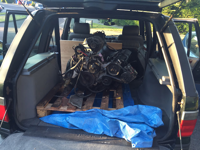

A couple of months back now, it got to the point where any more cosmetic/functional bits and pieces really weren't getting away from the fact the engine was letting things down big time. Economy on these is hilarious at best, but this was taking the piss and not giving any performance back for it. It has been oozing oil out of every possible place while at it and when driven hard, it really wasn't sounding happy.
Got round to doing a compression test with some oil in the cylinders and at that point I decided it needed sorting. I could either have it rebuilt, at a hell of a cost, with shiny top hat liners and the works, or risk a used engine. Given it was losing coolant somewhere, it probably had a crack behind a liner somewhere that the K-Seal 'sorted', so the block would have needed to be exchanged. I went with the latter after finding a complete 4.0 that appears as if it has been rebuilt recently. I have no idea if it has top hat liners or whether it was an old stock block (or if some company actually bothers rebuilding blocks with standard liners), but either way for the price, it was worth a chance.
I'm always having things delivered to work... but I think this tops it:
So I have downgraded from a 4.6 to a 4.0, but I don't really care - it dropped straight in, just needing the ECU settings changed to suit, and it makes all the same V8 noises. And, as you'll see from the couple of pictures I remembered to take, internally it is spotless. Under the sump was the same - it looked brand new. I did have a problem with a nasty knocking/tapping noise at first, which seems to be a lifter that took some thicker oil and time to pump up after not being run for a good couple of months. As an added bonus I now have an alternator, PS pump and A/C compressor spare. And as it came with rocker covers in decent shape, I've got the old ones I can have powder coated and swap over one day (the original paint seems to flake off of all of them eventually).
