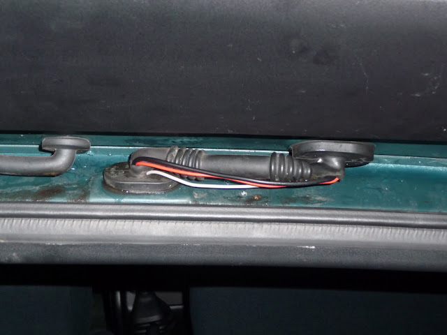

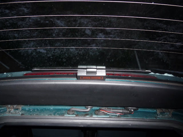

PostPosted: Sun Dec 19, 2010 5:17 pm
Joined: Fri Apr 03, 2009 9:01 pm
Posts: 2429
Location: Southampton
Reputation: 22
There we go :)
It has 3 connections - a short ground wire which I attached to a bolt under the plastics of the tailgate. Second is positive (the red you see in the second pic) which I connected to the remote wire for the old antenna, so it's only powered when the head unit is on. I think it's okay there, shouldn't take too much current.
Third is the coax signal cable, which has a moulded plug on the end of it and is quite long. Putting the wiring in was a lot easier with the roof lining prised down a bit, fairly easy to do, just unclip some of the trim around it in the car - should be able to see which bits when you attempt it.
edit- ignore the grey wire, that's for my boot release.
