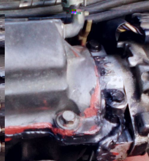

A few years ago I found this topic and replaced my distributor O-ring, but the oil leak didn't stop 100%. A few days ago I managed to stop 100% the oil leak from near the upper cilinder cap of the engine.
I dismounted the camshafts' holder/bearing that is in the same time the simering housing (sorry for my english, in the engine workshop manual it is called camshaft cap) from the belts side and remade the sealing with heat resistant silicon like in the bellow picture. I made the same thing with the camshaft cap from the distributor side.
After this the oil leak from the belts side stoped but not from the distributor side so I had to seal the cilinder head cover (engine top cap) from exterior in the semicircle zone of the distributor.After that the oil leakage stoped 100% (after 7 years I finally did it)
Last edited by marius-ciclistu on Sat Jul 09, 2016 7:02 pm, edited 5 times in total.

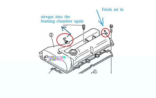

FoxXz wrote:
Hey Guyz Want to know whats that in photo attached?
What it for?
and where can get ?
Will this be good for My mazda 1995 1.5 DOHC 16v ? http://www.ebay.com/itm/DISTRIBUTOR-O-R ... 56467b900e
Hello. That is a second air filter for ventilating the cilinder cap space or the space in which the oil circulate in the engine, useful for prolonging the oil life because it puts back into the admission the gases that escapes the piston seals after the detonation. The gases from inside the engine(" oil space") are sucked into the admission through the valve shown in the bellow picture. That is what I've read about these 2 hoses that are onto the engine cap.
But the fact that in your picture, the air that enters eventually into the admission is not "measured" by the air sensor, makes me wonder about the efficiency of this method.
