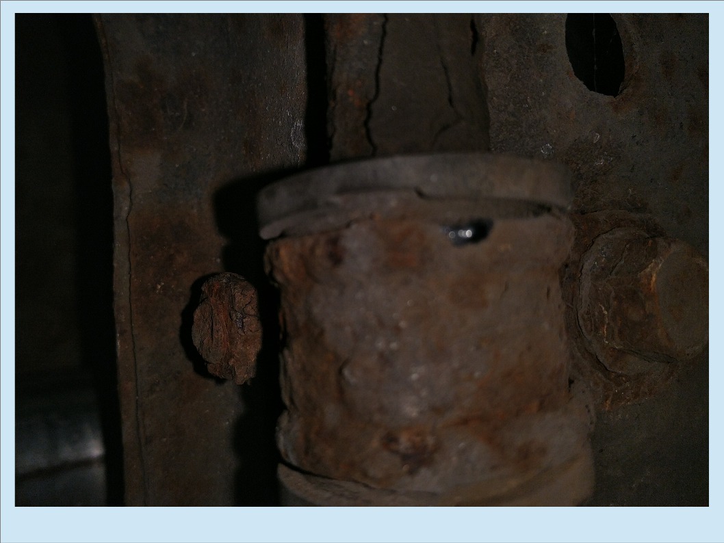

Is it me, or the bolt head on the sway bar bushing bracket is missing? :shock:
Maybe the rust ate it? :?
Cheers!

Hmm I see what you mean! I must get back underneath and have a look.
:oops:

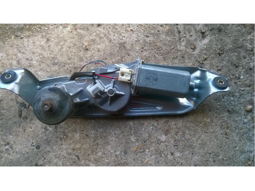

... meanwhile the rear wiper seized up, so I took a punt on an Ebay "used" one for £15, it seems to be ok now. Not too difficult to fit, but oh, those trim clips! Why make them so awkward, I really wouldn't mind having some small bolt heads showing through, then I can use a proper spanner!

I spent this afternoon under the BJ, and good news is both bolt and nut are there on both sides, but were covered in dirt, giving the impression they weren't there!
Rusty as well, yes. But not too bad for a 20-year old car on the original bits.
Thanks for the alert mazzda.

I'm glad that they are there!
One friend of mine had trouble just because of those bolts rusted as hell and the sway bar snapped them and it fell free from the brackets clunking like the car will split in pieces.I was at the rear seats, so i can tell you, it's the noisiest clunking i've heard from a car.. :roll:
