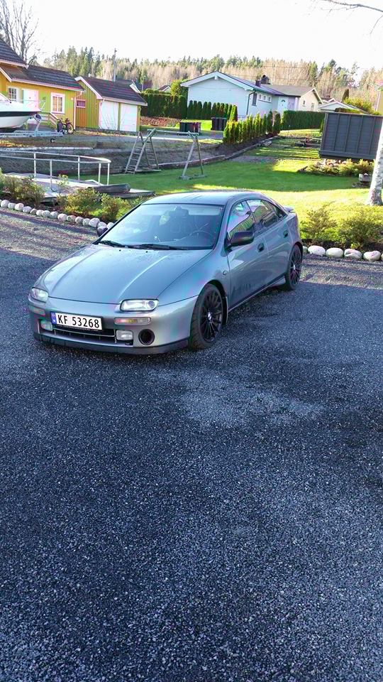

KLZE engine is now being prepped at WGT Auto,and should be in by the end of April With a Standalone :)
mods so far :
Homemade CAI With K&N Filter
BC Racing V1 Coilovers supporting 17" Rims Wrapped in R888`s
MazdaSpeed Front Strutbrace
WhiteLine Strut Rear
Custom Exhaust all the way (just modded some Probe headers,shes a screamer!)
Warlboro 255 fuel pump
will post more updates as the arrive this summer,chassi work is on the agenda ! :)
