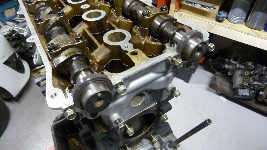

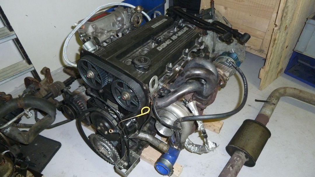

PostPosted: Wed Dec 07, 2011 7:26 pm
little update :
The story continues, i removed the GTXR engine from the BG, and i'm now rebuilding a N/A GT engine. It will have some of the GTXR engine like the megasquirt systeem, Edis ignition, injectors,fuelrail, turbo intake manifold, fidanza flywheel, stage 3 cintherbronze clutch, gearbox (willbe fitted with a phantomgrip diff)
and i will add a 4-2-1 Ford RS2000 header and make the exhaust a bit shorter to make a diffusor
pictures will follow, my goal is japfest second try :P

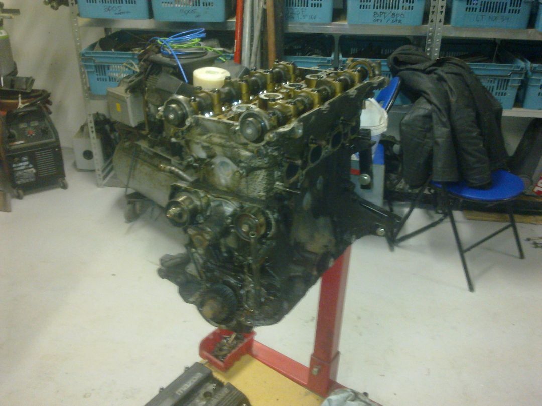

Update :
'new' GT in on the engine stand, (is it called this way?) ready to get some new gaskets, seals and new parts :) still dont have any photos (BARRELJAN had made some)

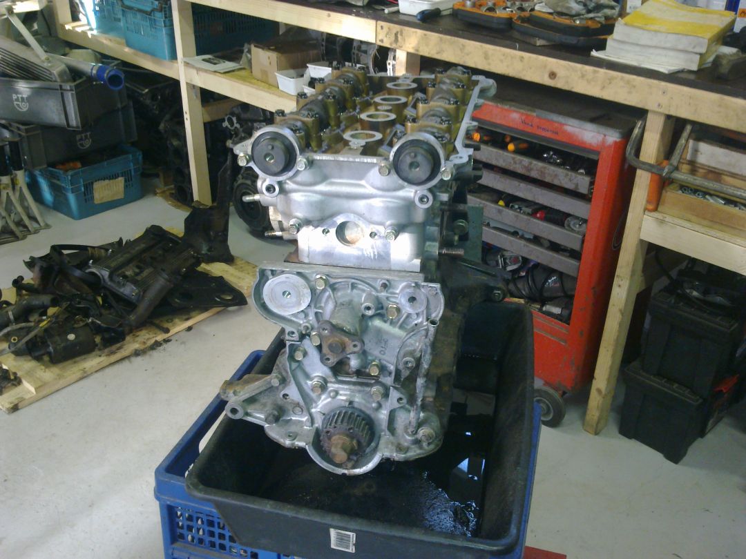

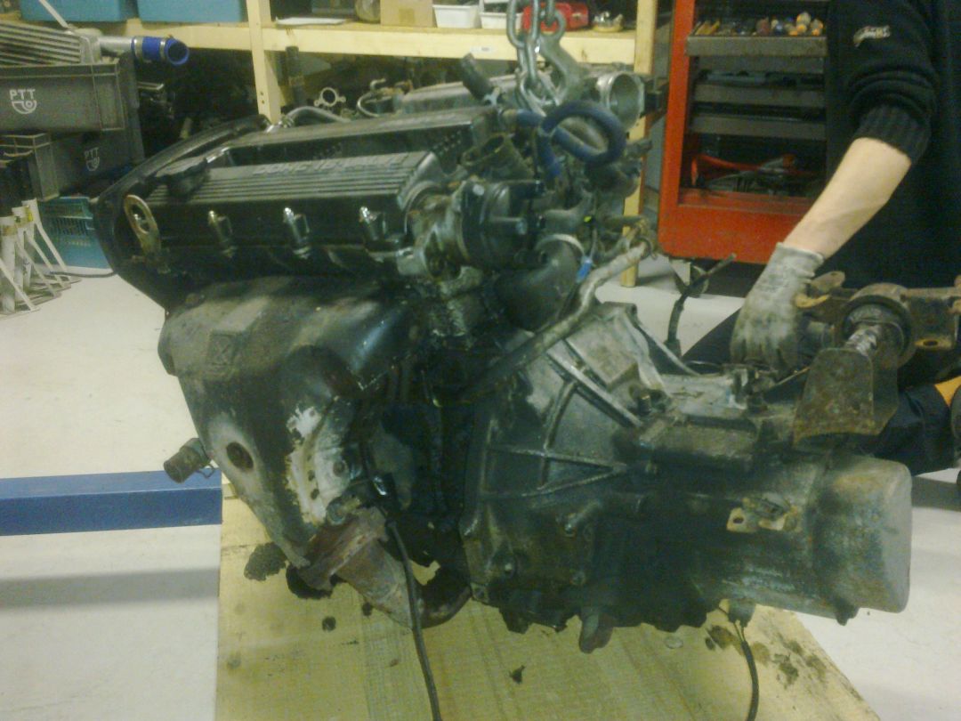

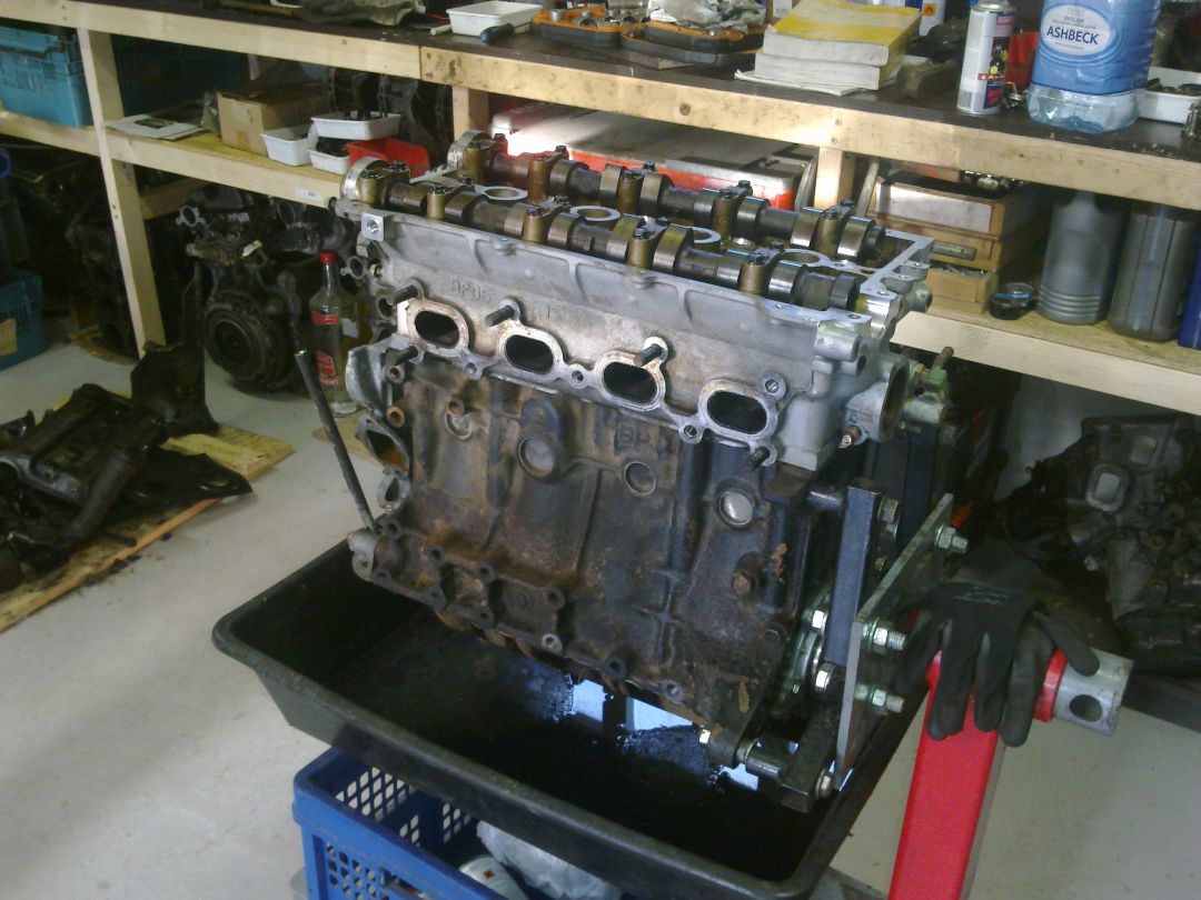

PostPosted: Thu Dec 08, 2011 9:45 pm
Out with the busted engine
Here some low-qual piccies of the most greasiest 1.8 GT engine. Ready to be cleaned

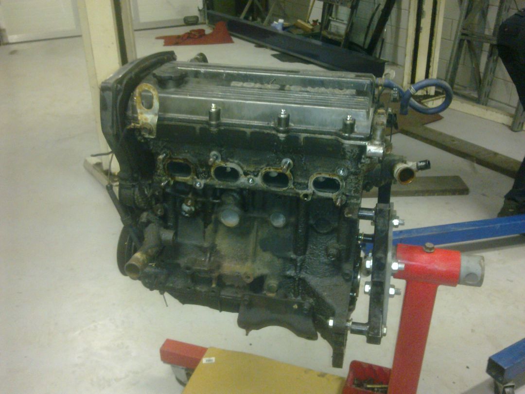

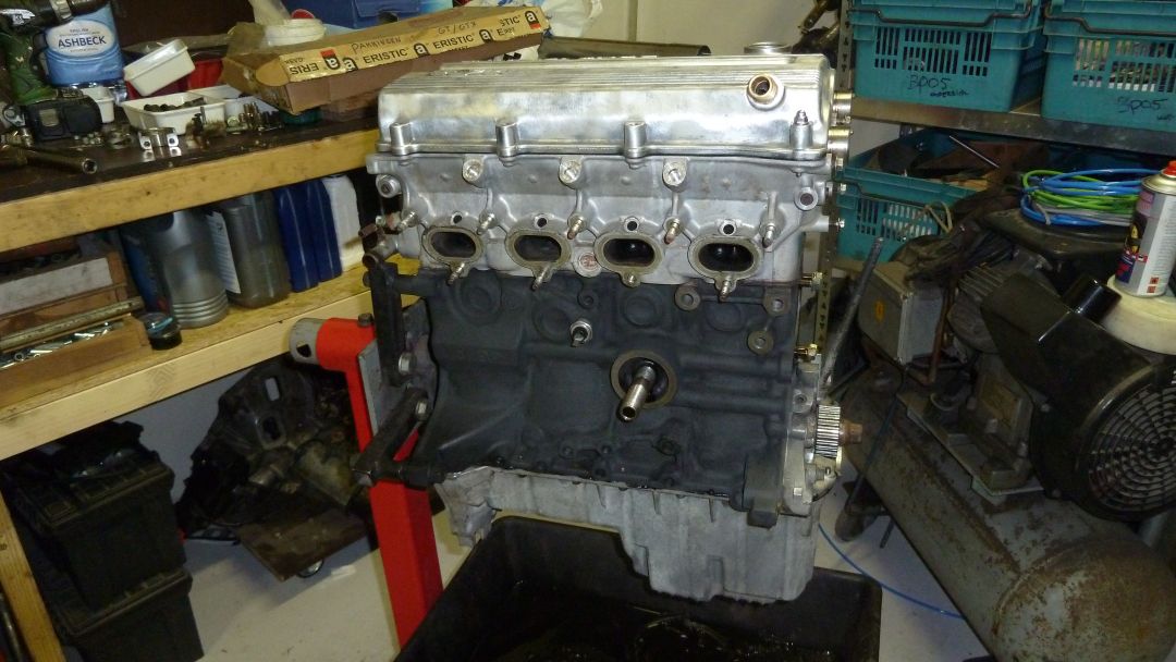

PostPosted: Sun Dec 11, 2011 12:19 pm

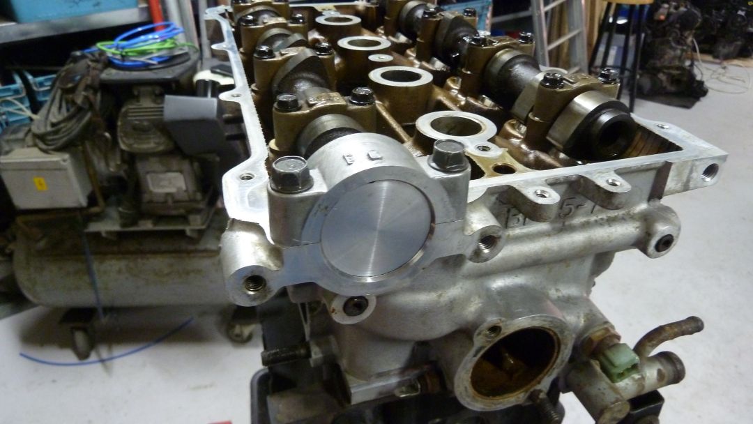

The outside of the engine is completely degreased
And later on, several old gaskets removed and some oilseals around the crankshaft and camshafts. Waterpump is removed and so on..

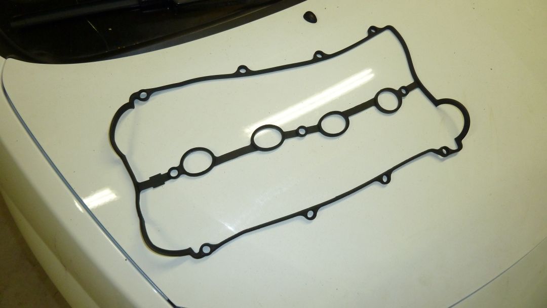

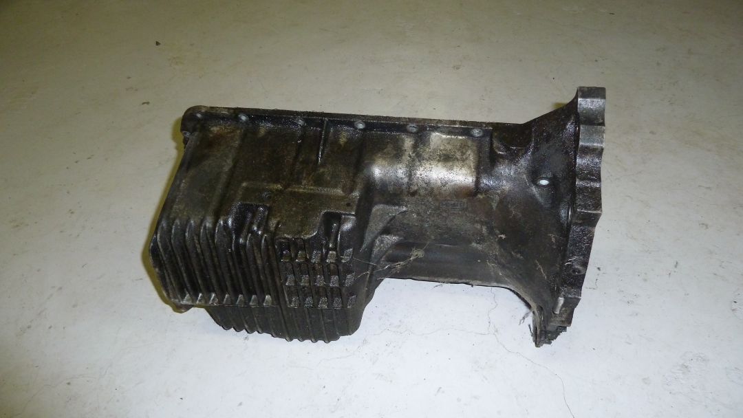

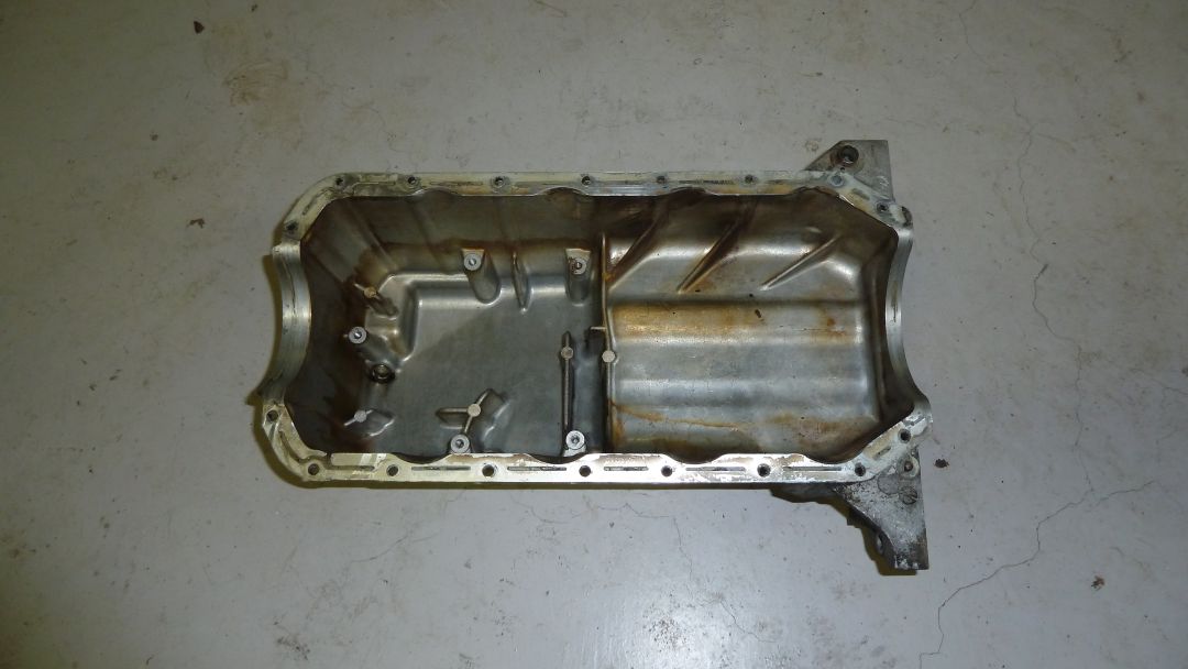

Updates for now:

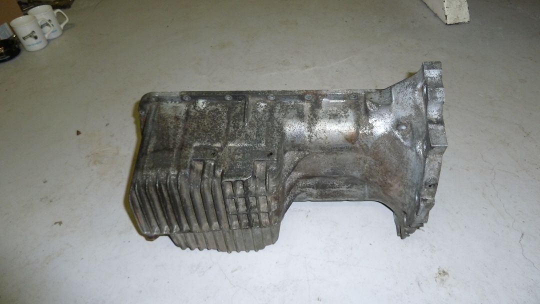

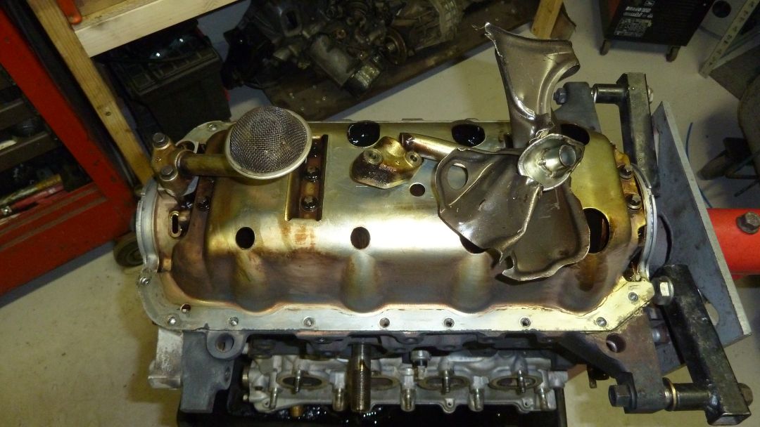

Arrived friday's, the new Mazda OEM rockercover gasket
'New' oil pan since the old one was busted (see here)
And degreased it
Inside all spankin' fresh
New oil sump including a fresh new gasket. The one on the right is the old one including a piece of the old oilpan
Next, sanded down the block , cleaned it and put on the heat-resistant paint to tidy it up. The oilpan is already in place and do not mind the ugly rockercover :oops: There will be an original black one on it tomorrow.

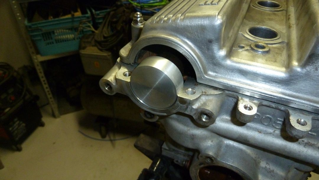

The dizzy plug. Perfect machined stop to block of the original hole for the distributor
