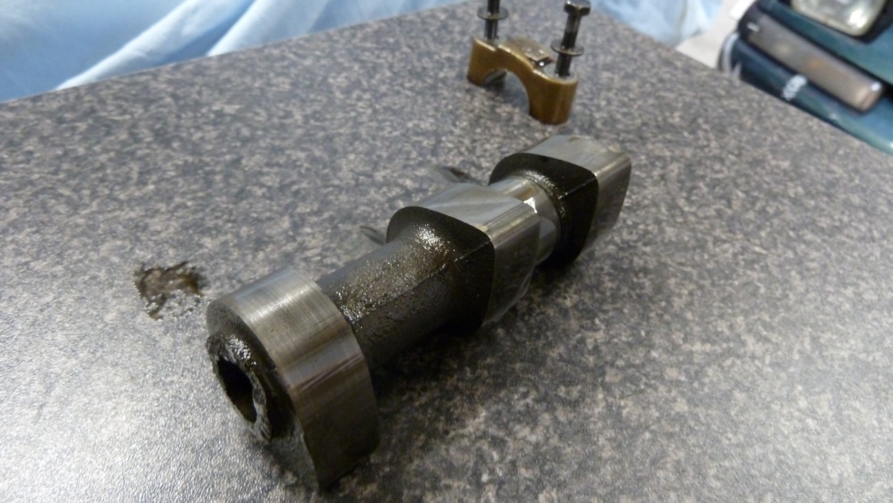

welll little update from accross the pond...
to be clear ; the engine died :? i have no idea what the exact probleme is, but i do know that its pretty serious, probably a valve, piston of the hydraulic valve lifters... i have to find out.
We were heading to the castlecomb circuit, only on the border of belgium and france the car stopt.. first we tought it was the sparkplugwiring again because 1 of them came of back in holland too.. but on that moment we noticed that the wiring was all fine, so we drove quickly to a garage nearby to buy some sparkplugs, mayby those where fried... nopee.. that wasnt it, no japfest for the BG :cry: when japfest ended we towed back home for like 400km's and now its standing in my garage....
soo now i have to sort out what the probleme is with the engine, i hope its an hydrauliclifter because those can be refitted very easly. i also have to buy some gaskets for the wastegate because that is leaking as well..
i'll keep you guys updated!

I've heard that the inlet camshaft has snapped into 2 pieces... but I will let Adri post the full details of the problem

The only ways I could possibly think of that happening:
1. incorrectly installed camshaft bearings
2. no camshaft bearings
3. magic
4. sabotage
5. camshaft already cracked maybe
6. magic
:lol:
PostPosted: Mon May 16, 2011 2:45 pm
I guess its #1... thanks to the previous owner, maybe.

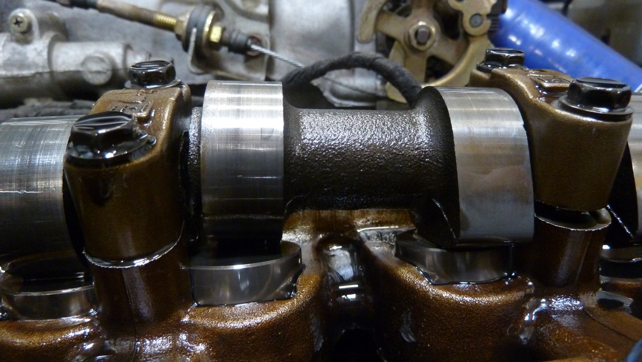

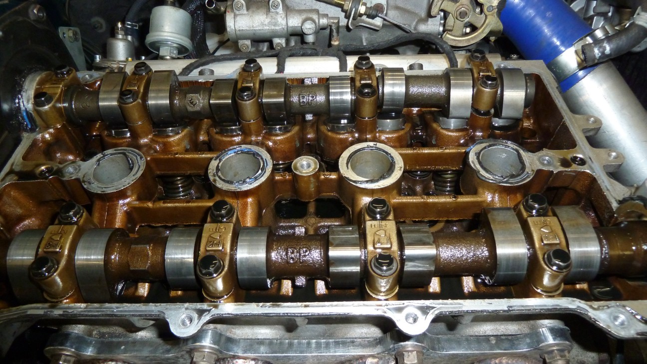

PostPosted: Mon May 16, 2011 8:07 pm
@ hughie : yes it was magic :lol:
no the previous owner didn't installed the bearings propperly so 2 bolts came loose and the bearing aswell. thanks to the rockercover the bolts stayed in place and the 1 piece of the cam shaft stayed on his place. Else it would fly all around the rocker cover and mess up more parts...
soo i installed a new (used) camshaft, new camshaft oilseals, new rockercover gasket, new sparkplug wiring, redid the timingbelt and its running like before :D :D :D so for now i have to instal new wastegate gaskets and manifold to turbo gasket because the leak alot.
Barreljan will upload some pictures with in a few hours :)

Anyhow:
Somethings not right there...
Nope, it's busted
And yes, the oil also needs a change.. god know whats in there after this
'95: 323F BA 2.5 V6 J-spec @ 290 pk/ 322 nm

Oh is the inlet cam different to the BP-05? I thought it was just the exhaust cam :evil4: there's a GTR breaking somewhere in the UK I'm sure :lol:
Whoever "fitted" that cam bearing needs shooting - that's clearly not bolted down properly :shock: glad it was an easy fix though :)
PostPosted: Mon May 16, 2011 9:41 pm
Jup, the inlet cam is different and yes a good whoopass will certainly be in place. It has not been tightend correctly else it hasn't been come undone..

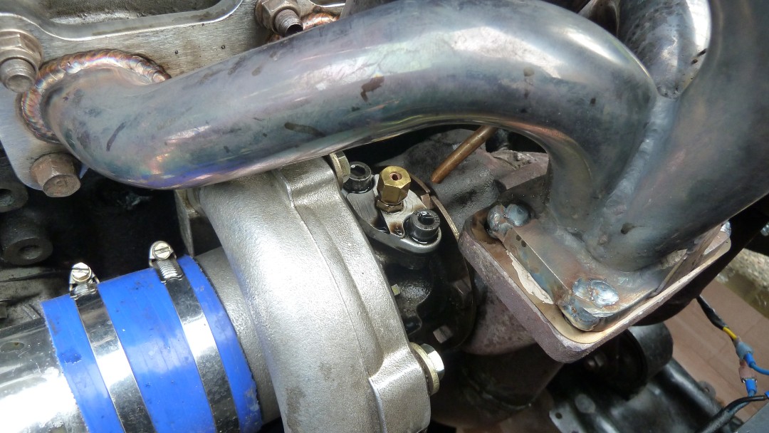

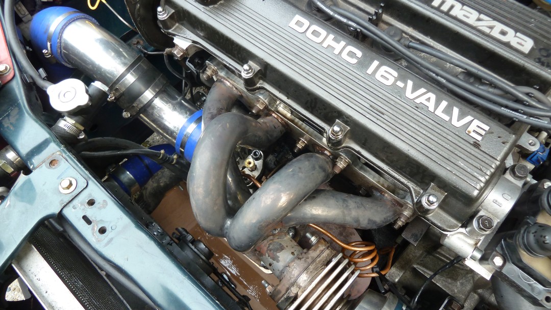

And... it broke down again, this time the oil feed for the turbo... and yes! again that oil line! :evil: The first time it teared off at the engine side, now the turbo side. Yet again 3 or 4 liters of expensive oil on the street
Starting to hate the damn engine, unreliable as &#!@$.
My brother 'Barreljan' already arranged a proper oil feed/return kit what probably keeps in one piece after more than 1000km, but it is in the shipping proces.

Hi mate, I hope the new kit is a flexible pipe and not similar to what you have, there is far to much vibration for copper pipes, hence it snapping.
New beginnings.
PostPosted: Mon Jun 06, 2011 10:59 am
Yes indeed, it will be something like this (quick piccie from the net)
