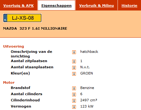

New Update 8)
(screenshot of the Dutch car Registration service)
It's now a official 2,5L V6 :D
more updates at JAE :cheers:

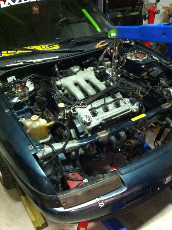

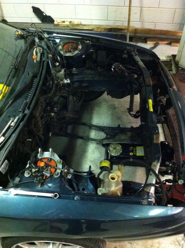

PostPosted: Tue Jul 08, 2014 10:47 am
So as some of you guys probably know that i have a 323F BG V6 KLDE run on the dyno a whoping 192bhp!
But thats not good enought. So we are goinig to replace it with the 5th and also the last engine.
My plan for this car/year is :
As light as possible and more powerrr
So we are goinig to replace the old KLDE with an KLZE, increase the output with aproxx 20-30bhp stock with some additional hp
I have sold my old KLDE and need a differend one. Well we had a KLZE in stock so lets use that one.
First step is make it run and MOT as last year a few day before JAE the MOT failed and i were not able to bring this fine piece of engineering to the UK. :lol:
Second step is to install the HPC-Inletmanifold and HPC-Flywheel, add a OBX crack pouly, megasquirt and EDIS ignition an your crank spins as a mad man.
We are not installing a Turbo, because this car will weight allot less than that fat BA we have in our shop :lol:
The current weigth on the licence is 1030KG with V6 and rollcage etc etc. I have simply removed some unneccesary parts and won 30kg! So 100kg to go.
It wont be done with JAE, but mayby next year its running like plan.
The main goal is : 900kg - 250bhp.

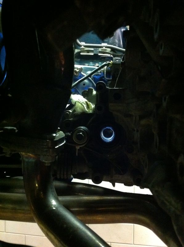

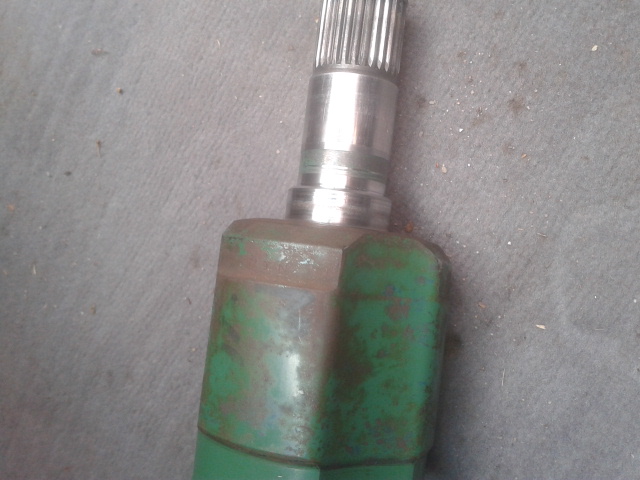

KLZE J-spec is installed, it works as well, only due to a mistake we need to swap the gearbox for a better one. :? But, as I was searching for a good K8/KF or KL gearbox I stumbled on the Lantis R LSD gearbox that we have lying around in the shop for quiet a while now.

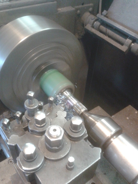

The only thing we don't have is proper axles for this gearbox. We tried allot of axles but non of them fit. I tried my MX3 axles and the short one on the right side fits great! the left side axels need some modification. I have to take of a few millimetres and then it will (probably :lol: ) fit. If not, a normal KF gearbox will be mounted and the whole car will be finished for MOT ASAP!
I am determined to come to JAE with my little Frankenstein :lol:
So up to the lathe!! :D

CV joint in the lathe, we have took around 4mm of
Modified CV joint, it is between steps, as I tried the first time it wouldn't fit so we had to mod it a bit more :)
Here you can see the that the Lantis R gearbox is installed, with a normal differential you see a axel in that same hole from the pinion wheels.
SO I have a j-spec KLZE with a J-spec gearbox managed by a J-spec KL31 Ecu... very Japanese :P
