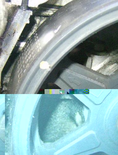

front or left head cam. 1 mark rear or right head 2 marks

Wow man thanks a lot ! As I won't buy insurance and mechanics will refuse me, I'm planning to do this all on my own and start disassembling it. If i fail to put it back I'll just sell pieces.
Tell me, do I need an elevator to get it going ? I have a garage with dig under the car, so i can get under safely.
I can see that the damn coolant hose is right between the two cams pulleys... it can get messy xD
Still.. how come I did move the distributor and no change ? Shouldn't it feel a change, like a desync if I adjust it badly ?

the ecu would have compensated for you moving it but under load it wouldnt have been able to compensate enough, strange as it may sound, because the ecu can compensate enough and cams are retarded together the 2 wrongs almost make it right. However the pistons are still not in optimum position so it would run but with less power per stroke.
you dont need to lift engine much but you will be removing the engine mount on that side for access along with all of the belts etc. The rear timing cover is a nightmare to get off due to the limited space but is possible.(after skinning all of your knuckles you may not believe me but it is) I would honestly just try and pull them back to try and look and only remove them if you can see that my diagnosis is right. If you've not changed anything in there and it has slipped the tensioner is most likely at fault and will need to be replaced so if your in that deep its best to replace the belt at the same time. The belts and tensioners are exactly the same through all of the k series v6's mx3 mx6 probe etc are all the same. I've changed my own timing belts 4 times (4 different engines) and not had to replace the pulleys (helps keep cost down)
