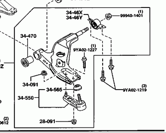

Hi there,
Has anyone here experience with the PU bushings from Superpro ? They (and i) have them for the BA 2.0 but im struggeling to get them in/on the front wishbone(s).
The original rubber at one side isn't even a conventional rubber with a steel insert but the rubber is filled with oil or something....
I was pushing the rubber out in a DIY style but all a sudden it squirted oil out on the walls and in my face :roll:
For the records, its the part 34-46X and Y on this picture:
[img]http://got.pc-mania.nl/draagarm.png[/img]
Is someone formiliar with this ?

I used a small handheld hydraulic press, brute force, and a small fire to get those f*** out! And yes, they are full of black shit!!! :lol:

The front wishbone one's are a b*****d to fit by all accounts! Due to the fact the engines coming out of mine, I was told it'd be easier to fit them then. Not much help that though :?

Well, there in !!!
If you don't have the hydraulic press it soo "aaarrghh"
Burnt down the rubbers (first bled the filled up one) then a saw to get the inner sleeve out like this at 0:44
http://www.youtube.com/watch?v=iG1hQlw6xMk
and followed by a lot of swearing : the new PU bushes did came in
Picces are still on the camera
